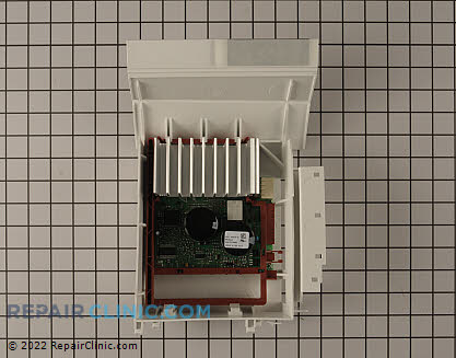

    Anyway, I have a Whirlpool duet washer. Model number GHW9300PW4 .I got an F11 error code on the washer and tried some of the things discussed on this site for similar duet washers. Not sure what to do specific to this model. Ran the diagnostic. Got C00 and C01 and then got the F11 error code again. I am a toolmaker by trade for 30 years and have good mechanical aptitude. I think I can fix it myself if I have some guidance.
    Can you please help me?
    77,278
    To Start a NEW THREAD:
    You go to the forum that your appliance is in, then you will see a
    "+ Post New Thread" button on the top left side of that forum, and thats it, just
    click + Post New Thread.
    Usually the F11 is the MCU.
    One member found detergent all over it, and he cleaned it all off and he was back in business. So check that first, also check it for any burnt components on the MCU.
    Here's the MCU(Motor Control Board) for your model, yes its located at the bottom left side when you open the bottom access panel:
    Control Board W10756692 Order now for same day shipping. 365 day return policy. RepairClinic.com
    If you purchase parts from our links here and you install them and it doesn't fix the problem, you have a 365 day full refund.

    Thank you, Jake. Is there a pdf file that has specific instructions on how to take that out and replace it? It looks like it is just snapped in there but I can't tell. Is it all "plug-ins" or is there some soldering required?
    77,278
    Its very simple, just unplug the washer first!
    You first remove the 3 bottom torx screws(all the way at the bottom next to the floor) then Remove the toe panel by lifting slightly and pulling forward.
    Then you will see the MCU on the left side, and you will see the mounting screws to it that mounts it to the washer base. Remove the electrical connections to the MCU first, they just pull off.
