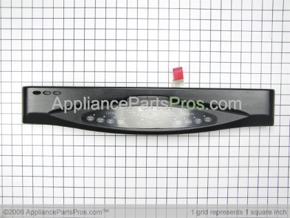

    Hi Jay,
    Unfortunately, these Maytag models have had numerous issues with the control board and control panels going out. I've replaced many of them myself.
    Its always best to replace both as they work together. Too many times I've been out to replace either one or the other, then a couple months later I'm back to replace the other, so from then on, I just started replacing them both at same time.
    Whirlpool 99003160 Control Board - AppliancePartsPros.com
    Here's the control panel for your model:
    Whirlpool 6-917732 Panel-Con - AppliancePartsPros.com
