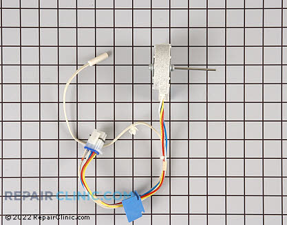

    Before you order it do you hear your freezer fan running in the freezer section?
    There has also been a issue where the freezer fan goes bad and takes the motherboard out with it, so you'd need to order both if that's the case with yours.
    Here's the evaporator fan motor for your model you can order:
    Evaporator Fan Motor WR60X10185 Order now for same day shipping. 365 day return policy. RepairClinic.com
    If you motor has a white thermistor in the connector you need this fan motor:
    Evaporator Fan Motor WR60X10074 Order now for same day shipping. 365 day return policy. RepairClinic.com
