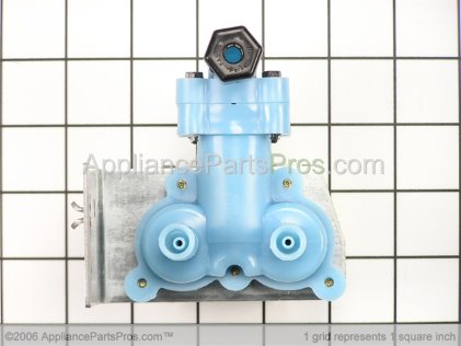

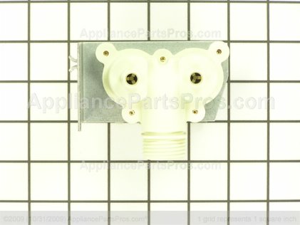

    Here's the secondary water inlet valve for your model you can order:
    Frigidaire 218658000 Water Valve - AppliancePartsPros.com
    Here's the main water inlet valve for your model you can order:
    Frigidaire 218698900 Valve/water - AppliancePartsPros.com

    Default how do I replace them, which go where?
    I'm ready to order the parts but I'm afraid I don't know what to do with them.
    76,082
    Very simple, they are both located in the back of your refrigerator, pull the refrigerator out from the wall, turn off your water supply, remove the lower access panel, and you should see both, one on one side, the other on the other side.
    Just change them out as you see them installed, they are mounted with 2 screws each to your inner cabinet.
    Wiring and tubing all go in the exact same place as the originals.
