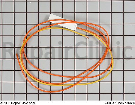

    Sounds like possibly the lid switch:
    Lid Switch Assembly WH12X10334 Order now for same day shipping. 365 day return policy. RepairClinic.com
    Yours is controlled by a magnet on the lid, if you have a magnet laying around somewhere test it with that, if it still doesn't work try to jump that lid switch.

    Thansk for the reply Jake, I did jumper the lid switch with no luck.. I will try putting a magnet to it today but if jumping it didnt fix it I dont think putting a magnet to it will
