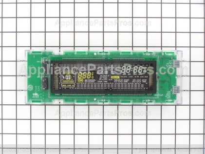

    Here's the display board for your model:
    Manufacturer's Number: 9762810
