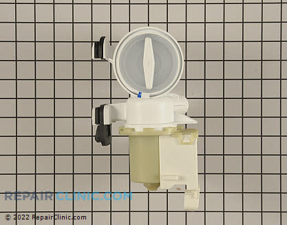

    Its either your water pump thats bad, or a clog in the water pump filter or the water pressure switch.
    Unplug the Machine
    Remove Three Torx (hex heads) screws on front bottom of machine. Slightly lift the panel and pull the bottom towards you. Pump is right in middle in front of you.
    Unscrew the pump handle with your hand, get something to catch the water thats left in it in.
    Here's the water pump for your model:
    Drain Pump W10130913 Order now for same day shipping. 365 day return policy. RepairClinic.com

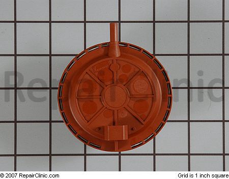

    If your water pump and water pump filter check good, then its your water pressure switch.:
    Pressure Switch W10163980 Order now for same day shipping. 365 day return policy. RepairClinic.com

    took hose off the pressure switch and blew into it as suggested by others and it definitely had water in it..... blew again to make sure it was clear.... and bam... test cycle worked, a rinse and spin worked... and now a full empty cycle ran...
    Try that as well.
    Here's the pressure switch for your model: Pressure Switch W10514214 Order now for same day shipping. 365 day return policy. RepairClinic.com
