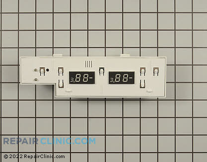

    It has been 2days now that the refrigerator has been CONTINUOUSLY beeping without displaying any error codes or allowing me to control the temperature or anything.
    I have tried to reset it or turn it on/off by leaving my finger on the "Freezer/Fridge on/off" button but nothing gives.
    The refrigerator is not refrigerating and I don't here the fan go on or the compressor.
    The inside light works, the water comes out from the water dispenser and so does the ice.
    I am assuming its something to do with the control board.
    Can someone tell me what I need to do to get this refrigerator to work again?
    Thank You
    78,123
    Ok, I found it.
    Its your main control assembly, you can order it here:
    Frigidaire 241739711 Board-Switch,terminal Beta
    Its #23 here: 11-Controls parts for Frigidaire PHS38EJSB0

    Hey,
    You were right, that was the broken piece!
    Thank You so much!
    All works now.

    I have a frigidaire side by side model #GLHS66EJW0 which also has power in lights and dispenser but no power in temp control. A constant beeping is the alarm. I have since cut power and am waiting to find out what to do next. The unit is two years old from time of purchase.
    I noticed you helped another person by suggesting a control assembly. If that is what I need, where do I order such a device and is this something a handy man can install?
    78,123
    Yes,
    Sounds like you will need a new one too, its the same part# as guesswho's:
    Frigidaire 241739711 Board-Switch,terminal Beta - AppliancePartsPros.com
    Then to install it you remove the #81 screws here: 11-Controls parts for Frigidaire PHS38EJSB0
    And the console drops down then you can access and replace it. Unplug your refrigerator first.
