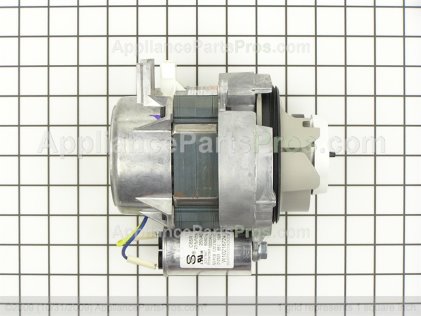

    Here's the wash motor assembly for your model:
    Whirlpool W10239404 Circulation Motor - AppliancePartsPros.com
    Here's the sump/wash motor assembly for your model you can order: Manufacturer's Number: W10237169
