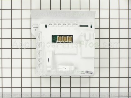

    The f28 serial communication error is coming up. Do I need to take the machine apart to check if its a loose connection. thank for any help you can provide.
    78,711
    Thanks, glad our site helped you fix your refrigerator.
    Yes for the F28 error code:
    First, check the wiring harness connections to the MCU, the Motor, and the CCU. Make sure all the connections are tight and there are no ground wires off. Then check the connections of the CCU board within the housing.
    If the wiring connections are fine then It would be a good idea to order both, as both components have been problematic for the error code F28.
    Here's the CCU for your model you can order:
    Main Control Board W10679602 Order now for same day shipping. 365 day return policy. RepairClinic.com
    Here's the MCU for your model you can order:
    Motor Control Board W10163007 Order now for same day shipping. 365 day return policy. RepairClinic.com
    You may also want to remove the MCU board from its plastic casing, and look for burned/arc spots on it, we've had a few members report that. If you find yours does, just order the MCU.
    If you find either the MCU or the CCU(Microcomputer Machine Control Unit) fixed it, you can return the one that you don't need for a full refund, less shipping.
