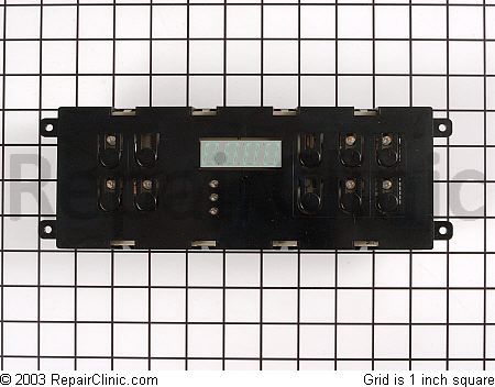

    Tonight after making dinner we got the F1 fault display and could not turn off the oven. Other buttons on the panel would work, timer, lock,etc. but the oven would not turn off. I flipped the breaker to turn it off. Any help would be greatly appreciated.
    77,266
    Its either your bake element is grounding out, or your control board is bad.
    If you turn the breaker to your range back ON now does the element come on by itself?
    If the element doesn't come back ON by itself, Then your control board is bad for sure.
    Here's the electronic clock oven control board for your model you can order here:
    Oven Control Board 316207522 Order now for same day shipping. 365 day return policy. RepairClinic.com

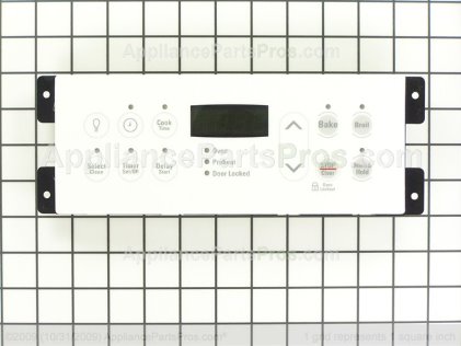

    My stove is a Kenmore Model# 790.46582500. I just replaced the oven sensor and the F1 code (with beep) continues....
    Aug 2010
    eugene, or
    ... furthermore, the surface units work. The oven works - comes up to the temp called for and then the 3 short beeps. The broiler works on both LO and HI. When oven or broiler are working I have no F1 and no beep but shortly after turning them off I get good ole F1 and that darn beep.
    Whatdya think?
    77,266
    You will need to order the clock/oven control board for yours.
    Here's the clock/oven control board for your model you can order:
    Frigidaire 318296800 Clock/timer - AppliancePartsPros.com
