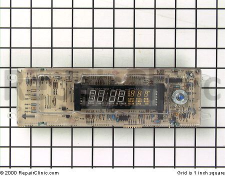

    I have a s176 Jenn Air electric stove, this morning we had to turn the power off to change a light fixture and upon turning the power bk on the stove clock/oven display is not working. The range works and lights up but nothing that has to do with the stove,
    any ideas?
    77,050
    It would be the clock/oven control board assembly thats bad.
    Here's the one for your model you can order here:
    Manufacturer part number Y04100262 is RepairClinic item number 1242521
