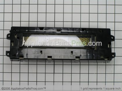

    greetings all gurus, i am a newbie here and in the field of fix-it-yourself. recently my kenmore double oven started beeping and display the error code F7 next to the clock and all buttons stopped working. i have searched the net, including this forum, and found a solution of power off the oven, disconnect and reconnect the ribbon connector to the ERC and power back on the oven. that worked the first time for about 3 months and now the code F7 is back and repeating the previous steps did not work this time.
    so upon further research and recommendation, the instruction of powering off, disconnect the ribbon connector and leaving it off and power back on the over should determine whether if i have a bad key panel or a bad control unit. after following those steps, the F7 code no longer appeared but the key panel beeped and followed by displaying code F0 after couple minutes, which is a new code for me.
    is this a pretty clear indication of a bad control unit or is this something else? if it is the control unit, is part# WB27T10345 correct and where would be the cheapest place for me to purchase one?
    thank you all in advance.
    79,324
    Yes, that F0 error code means the ERC is bad.
    Here's the ERC for your model you can order here:
    GE WB27T10345 Oven Control
    For the F7 error code:
    Here is a test to find out whether its your control panel or control board:
    Determine if problem is with the Key Panel or Control Board by:
    1. Pushing CLEAR/OFF pad.
    2. Disconnecting Ribbon Cable from control and waiting at least 32 seconds to see if Code recurs
    If code recurs, problem is in the control. Replace control board.
    If code does not recur, problem is with the Key Panel.
    What color is your key panel? Black or White?

    hi jake, thank you for the quick reply.
    after i tried the test, F7 code did not come back on but the F0 code did after couple of minutes. so is that the indication i have a bad control panel? is the ERC and the control panel the same?
    thank you.
    79,324
    Yes, if the F0 code came back, then its your ERC.
    Nope, the ERC is your clock assembly, the control panel is your keypad assembly where you press the buttons.

    hi jake, the ERC arrived this morning and i replace it. everything went smoothly and no more error codes. but now the only button that seems to work is the clear/off button and the clock but nothing else. does that mean i either mess up the connections to the ERC or do i have a bad key panel too? my double oven is black color.
    thank you.
    Aug 2010
    texas
    7
    ok 10 minutes after i post my last comment, oven started to beep and F7 showed up again. this is about 4 hours after i switch out the new ERC. so i went ahead and disconnect the ribbon connector and turn the power back on. about another 10 minutes later, F0 showed up. what do i do now?
    79,324
    Then its the control panel you'll need.
    What color is yours?
    You can return that ERC back for a full refund. You invoice that you got with it, explains how to return it.
    79,324
    Its odd the F0 still shows up too, F0 always means bad ERC.
    Both may be bad, so I'd wait till your new control panel comes in and see if your old ERC works with the new control panel. If so, then return the new ERC.
