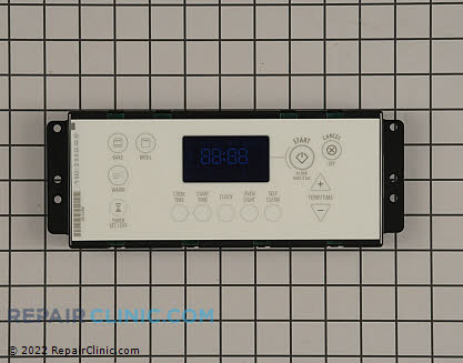

    Hello. The problem is this: The oven and the broil will not work. The burners on top work fine. When you set it to broil, after a few seconds you will hear the clicking of the starter but the gas does not come on. When you try and use the stove, there again is no gas and it doesn't click either. I have read the forums a few days ago that it could be the dsi board so I bought one and it didn't fix it so I will send it back for a refund since I bought it from repairclinic. What do I do next? I read on the forums that it may be the gas valve. I was just wondering since there is no clicking from the igniter when I try to start the oven, could it be a bad igniter and causing the gas to not come on for the oven and the broiler for a safety precaution? I just know how electronics are, if one thing fouls up it can confuse everything else. If anyone has any ideas I would greatly appreciate it. Thank you.

    Ok. I did some tests on the stove. I did what you said Jake to check the error codes and it showed 600D. I checked the oven ignitor and it seemed to be ok no cracks or anything. I tested the ohms on the gas valve and the broil side showed around 197 which is ok and the oven side was at around 1800 and the oven side is where the ignitor doesn't work too. When I checked them for voltage during the bake and broil modes they showed no voltage. With the gas valve on the ohm meter reading 1800, does this mean I need to order a new gas valve or where or what should I check or test next? Thanks. Chris
    76,046
    You did the flow chart at the bottom of the manual link I posted above?
    Is 120 Volts present from J1-4 to J1-6?
    If not, it says replace the EOC which is your clock control board assembly.
    What color is yours?
    Here's the white one for your model:
    Whirlpool W10424331 Electronic Control Board - AppliancePartsPros.com

    Ok Jake. I tested for 120 vac during back and it showed nothing. So hopefully it means we have found the problem which is the clock board. The color I need is black. Thanks
    Nov 2010
    Indiana
    13
    Just one more thing. Since no gas comes out on bake or broil and I did get a strange reading on the bake side, should I order a gas valve as well? If the clock board is bad, does it control the gas valve too?
    76,046
    Here's the black clock control board for your model:
    Whirlpool W10424330 Electronic Control Board - AppliancePartsPros.com
    Yes, it does, but I'd order the gas valve as well for that strange reading, just in case, you can always return it for a full refund(minus shipping back) if you don't need it.
    Here's the gas valve for your model:
    Whirlpool W10293048 Valve-Gas - AppliancePartsPros.com
