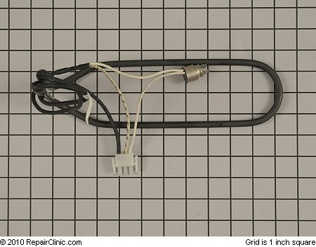

    If so Ohm your defrost thermostat for continuity while its still frosty to get a proper reading, should read 0-1 ohm. If the defrost thermostat is not frosty when you ohm it, you will get a high reading.
    Here's the defrost thermostat heater assembly for your model:
    Defrost Heater Assembly 61006199 Order now for same day shipping. 365 day return policy.
    Put your ohm meter probes in the 2 white wire plastic connections, remember it has to be still frosty for a proper reading. Should read 0 ohms.
    Then put your ohm meter probes in the black and middle white wire plastic connections, that will ohm your defrost heater, should read between 11-50 ohms.
    Unplug your refrigerator first!
    If the defrost thermostat ohms at 0-1 while its frosty, and the defrost heater is between 11-50 ohms then order the adaptive defrost control board.
