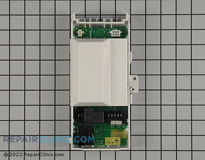

    Well, I THOUGHT I had the problem solved but the timer still keeps sticking at the seven minute mark and the clothes still over heat. I called the Sears parts department and asked about replacing the timer. They have two parts that refer to the timer. One is the control board behind the knob that's $119.00 and a "user interface" that is $98.00. It doesn't seem like it should be that difficult to replace the timer. I assume it's the timer but if it sticks, it has to at least part of the problem. Suggestion as to where to head next or which part to replace first? Thanks in advance.

    #3 is the user interface, and #6 is the control board here:
    http://c.searspartsdirect.com/lis_pn...1017-00001.png
    I'd first try to clean the moisture sensor bars with rubbing alcohol and see if that makes a difference, as those can get a build-up on them and cause this issue as well.
    Its located under the filter housing inside the door, its #34 here:
    http://c.searspartsdirect.com/lis_pn...1017-00003.png
    Ok, here's the user interface for your model, actually this one has the knob control on it:
    Manufacturer part number 8564394 is RepairClinic item number 1180387
    Manufacturer part number W10111617 is RepairClinic item number 1470202
