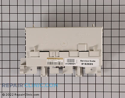

    To check the CCU:
    Unplug your washer for 1 minute, then:
    Check for voltage going to Central Control Unit (CCU) by listening for a click in the CCU when unit is plugged in. If no click replace CCU.
    Do you hear the click when you plug your washer back in?
    Here's the CCU for your model you can order here if needed:
    Main Control Board 8182695 Order now for same day shipping. 365 day return policy. RepairClinic.com
