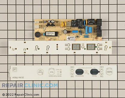

    Waking this one up. It's been 1.5 years since I first reported this and this problem kept showing up every now and then. So I'd do the warm water thing and we'd be okay for 3 months. But now it's getting to the point that it never drains. It finally dawned on me that perhaps the freezer is getting too cold. I confirmed that by turning the temp all the way warm (+5f) and putting a thermometer in there. It is holding pretty steady at -25 to -30. So I'm guessing that is the root of my problem here!
    Fridge side is fine. Keeps temp well.
    Is this a thermostat issue? If so, where can I get the parts and what parts do I need?
    77,329
    Yup, thats why too cold.
    The temperature issue would either be caused by a bad thermistor or control board, thats the only parts that controls the temperature.
    The thermistor is #23 here: http://c.searspartsdirect.com/lis_pn...4027-00002.png
    You have to remove the #17 channel, and #16 cover to access it from the refrigerator section. To test it you ohm it with an multimeter, you put the sensor in cup of ice water for 5 minutes and it should read about 8.7 K ohms.
    Here's the thermistor for your model you can order here:
    Part#2188819
    Thermistor
    If the thermistor reads about 8.7 ohms(+/- 5%) in a cup of ice water then its good.Then you'd know you need to order a new control board.
    Here's the control board for your model you can order here($35 CASHBACK offer):
    Main Control Board 8201660 Order now for same day shipping. 365 day return policy. RepairClinic.com
