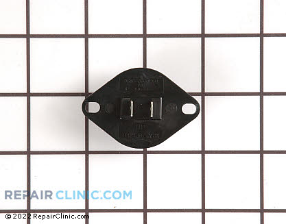

    My dryer beeps three times when I hit the start button in any setting. When I checked the error code (no digital display) it says 9 5 but I dont see any error 95 in the repair manual. I performed all the test in the manual and the drum spins and heats so I don't know what wrong then. Any ideas.

    It sounds like your thermistor or control board is bad.
    Here's the repair manual for the Frigidaire & Kenmore(417) Dryers made after Jan. 2005:
    http://www.applianceblog.com/manuals...Dryer_2005.pdf
    You would need a ohm meter to ohm test the thermistor at room temp. with the dryer unplugged.
    It should read 50K-53K ohms at room temperature, if not, then order the new one and you'll be back in business.
    Here's the one for your model you can order if you need it:
    Manufacturer Number 134587700
    Here's the control board assembly for your model you can order:
    Manufacturer part number 134484214 is RepairClinic item number 1154877
    134484214
    Yes, If you purchase parts from our links here and you install them and it doesn't fix the problem, you have a 365 day full refund when you return them.
    Now some members have reported they found the thermistor bad and replaced it then it worked fine for about 6 loads then started doing the same thing again, and the control board fixed it. So if you find the thermistor bad order both the control board and thermistor.

    Thanks, I bought the parts and replaced them and it works. Thanks a lot, I learned something new.
