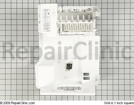

    Ice Maker in door not working. Auger wants to dispense Ice and is working. Ice Maker is getting cold and I have had it in off position for the last day to see if something was frozen up. It appears that the Ice Maker is getting cold enough to make ice, but it not dispensing it into the bin. This is stopping the ice maker from repeating the process. Any thoughts on troubleshooting and getting the right parts?

    Thanks. Not sure if the other post is the same problem as mine. I had the Ice Maker off so that it would thaw and eliminate something that might be frozen in place. Turned it back on this morning after posting my post and it filled the Ice Maker with water and they have frozen, but they aren't being released into the ice bin. I don't know if this helps to troubleshoot.
    Is the Ice Maker assembly one whole unit? I had another problem some time back and you suggested I replace the control circuit board and that solved my problem and your help is appreciated.

    Then yes in your case the ice maker itself is the cause, you'd need to order a new ice maker.
    Here's the ice maker for your model:
    Ice Maker Assembly 4681JA1006D Order now for same day shipping. 365 day return policy. RepairClinic.com
