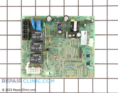

    2) Unrelated to the ice-maker problem, several months ago, the refrigerator side's light didn't work right and we heard a clicking/buzzing noise when the refrigerator door was open. I taped down the switch that activates the interior light and the noise stopped. Any ideas? We're okay with having a dark refrigerator, but since I came to the experts, I thought I'd ask!

    The lights not working in the refrigerator are most likely due to a bad control board. It's located by the compressor and at this time I'm not sure if it has anything to do with the ice maker or not. I'm trying to look it up but it might take a while. Take the control board out and take a look at it. See if there are any burn marks on it. Here is the part for your model:
    Control Board W10135090 Order now for same day shipping. 365 day return policy. RepairClinic.com
    I am (of course) no expert on this, but the light hasn't worked in months, maybe more than a year (we can't even remember), so I'd be a bit surprised if the two problems were connected. The compressor is in the back/bottom, perhaps? Is there a good source for a "map" of the control boards' locations?

    The optics replacement is really easy and it does have instructions. Why it would cause the water to overflow, I'm not sure. I guess it depends where the ice maker is in a harvest cycle. Here's the deal with the board; When Whirlpool first came out with that board I had a service call where the lights wouldn't work and the display wouldn't light up. I checked the bulbs and the door switch and both checked good so I assumed there was a broken wire in the cabinet somewhere. My customer was ok without lights untill a couple months later when there was a cooling issue. I replaced the board and the lights and display worked and it fixed the cooling issue. So I guess as long as the machine is working ok and you don't mind no lights, it's not a big deal. Wheather it will give you a problem with cooling later, I don't know. It's in back on the left side of the compressor and I believe there is a cover over it.
    I found the board right where you said it would be, and when we open the door (with the light switch un-taped), the slow buzzing is coming right from that board. Maybe it's something shorting out rapidly, I don't know, but the board is the source. I am okay with no light, but if it can also cause a cooling problem later, I'd rather replace it now and not worry about it.
    So, I'll have a couple new boards ordered soon, and I thank you VERY much for your help. I would have probably replaced a perfectly good ice-maker (and still had the same problem in the end). I'll report back once I've installed the boards.

    The control board (in the back of the fridge) was definitely bad -- the buzzing was an electrical arcing (I could see the small scorch marks on the back of the board after pulling it out). I replaced the board and the light in the fridge side now works.
