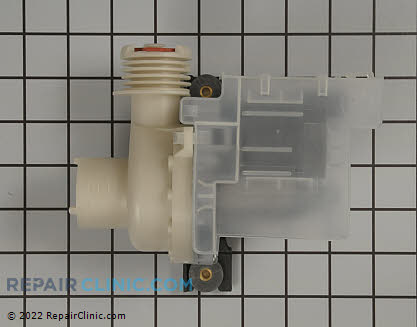

    Thanks Jake, it is E21....... Now to check pump
    79,241
    Yup,
    I agree sounds like a clog in your drain pump, or your drain pump is bad.
    Drain Pump 137221600 Order now for same day shipping. 365 day return policy. RepairClinic.com
