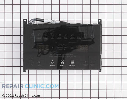

    Alright got the new part installed and same problem. High temp light thinks it is 32 degrees in there. Manual thermometer inside shows right around 0 or a little lower. No lights, water, or anything. Any other ideas?
    71,646
    Thats odd, what board did the tech. change out?
    Your not having very good luck with this Electrolux model if your on the 2nd one, and now this one is giving you problems.
    You can return the control board for a full refund.
    The only other possiblity I can see is the Dispenser board with touchpad kit, Electrolux has upgraded this:
    Manufacturer Number 5303918539
    But its currently $449 for this kit, I'd contact Electrolux directly and let them know the issues you've had, and they may send this kit out for free.

    Sorry for the confusion. This is still the original fridge. They never replaced it, rather Lowe's just refunded our money but still let us keep the fridge. Since it still keeps good temps and the ice maker works couldn't justify throwing it away. So I figured it was worth trying a couple things.
    Will talk with the wife and might as well try out that kit that you showed there. With being able to send the parts back I am not as reluctant to try out parts. I will order those and let you know how it goes.
    And as for what parts did the technician replace, honestly I am not sure. I did see him removing the bezel around the water and area the last time he was there. Worth giving it a shot at least. Again appreciate the help and will update the post once I get the parts.
