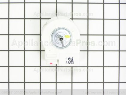

    I haven't worked on this model as of yet, but it sounds like your evaporator fan motor is bad, touch it and see if its warm.
    Here's the evaporator fan motor for your model you can order here:
    Samsung DA31-00146H Motor

    THANK YOU so much for responding! Yes, the motor was very hot when I opened it up. I will order the part right now!
