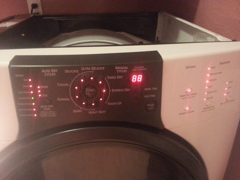

    here are some pictures... of what i get when i got into the diagnostic mode..
    1st i get all the lights and 88 shows up.. if i open door, it goes away and comes back when i shut it again..

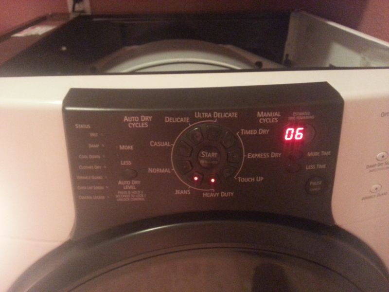

    2ndly.. i depressed all the buttons but these two buttons will not do anything (no beep or light turn off) - Jeans and Heavy Duty
    3rdly.. i pressed the hold to start test.. and i hear a click and 06 shows up on the display..

    OK, listen to me Johnny my friend, just answer the questions and we can tell you what to check next instead of getting ahead of us. If you got the motor from RepairClinic, you can return it. When you did the HOLD TO START test, you got a project Id number but the motor didn't start, right? So now you need to check for supply voltage going to the motor. When you push the START button to start the machine, on the control board, check for 120 VAC between P1-2 white wire (Neutral) and P1-4 light blue wire (Motor). Make sure the door is closed. If you don't have the correct voltage, order the control board from the link Jake gave you.

    76,146
    Yes, Rick is correct.
    From others who had this issue, a new control board fixed theirs. So I'd order the control board.
