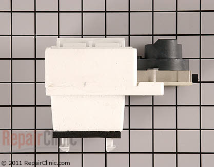

    Ok, I am still troubleshooting my issue, and here is the latest. I felt almost zero air flow from the diffuser. Upon inspection, the diffuser was totally shut. I opened it with the end of my thermometer, and instantly felt cool air rushing into the fridge side. I left it open to see if it would cool down completely. About 30 minutes later, I found the diffuser had shut itself, and the air temp in the fridge side was getting warmer again.
    So, I poked my thermometer into it again, and left it there to hold it open. About 10 minutes later, the temp has dropped down to almost 40 degrees F already.
    Sounds like my diffuser is bad.....or is it? Is it the diffuser, or the thermostat, or the circuit board? How can I tell which one is the culprit?
    77,726
    Yes, sounds like you had two problems, one being a bad compressor start relay, and yes you installed the correct one for your model.
    From the information about your air diffuser not staying open, sounds like a bad air diffuser, I've changed many air diffusers for this problem.
    Here's the air diffuser for your model you can order here:
    Damper 2216112 Order now for same day shipping. 365 day return policy. RepairClinic.com
    If I was you I'd replace both the air diffuser and thermistor, since the thermistor is in the same location as the air diffuser, and they both work together.
    Here's the thermistor for your model you can order here:
    Thermistor 2188819 Order now for same day shipping. 365 day return policy. RepairClinic.com

    Finally my issue is resolved!! It was the diffuser that was causing my issue. I did originally have a bad relay also, and I am not sure how 2 problems existed without me seeing the effects of the first one. But, all is well and my Fridge has cold air again!!
    I let it sit overnight before I claimed victory. It has been hovering at 40 degrees for about 15 hours now. I think it is finally resolved!!
