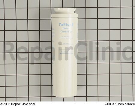

    Here's the water filter for this model:
    Manufacturer part number UKF8001 is RepairClinic item number 1446373
    Some members have reported if they haven't changed the water filter in awhile then change it, it causes the water filter head to stop working properly, then you have to change the water filter head.
    Here's the bypass plug for your model:
    Water Filter Bypass Plug 12664501 Order now for same day shipping. 365 day return policy. RepairClinic.com
