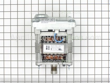

    washer will not spin.. code says brake resistor open. rep-lace motor (brake) what and where is this, how much $$.
    79,324
    On Page 25 and page 41 it explains about this in the service manual here: http://www.applianceblog.com/manuals...monyWasher.pdf
    Are you sure you posted the correct model#? I don't see a brake resistor or inverter on this model.

    This doesn't make any sense to me then, brake resistor and inverter are only on models with an electronic control board, that model# you posted only has a timer no control board in the control panel.

    The GE washers with motor/inverter are used on both timer style and electronic control board style. The brake resistor is built into the top cover of the inverter and is not replaceable. You must replace the entire motor/inverter.

    Thanks Eric for clearing that up.
    Here's the motor/inverter assembly for your model you can order here:
    GE WH20X10057 Motor/inverter-2 Spd E/m - AppliancePartsPros.com
