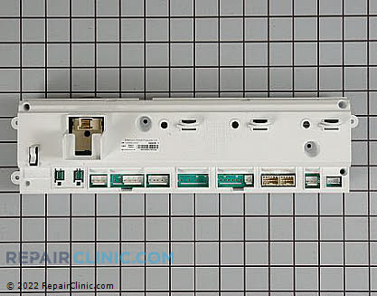

    I have a Frigidaire front loading washer (model LTF6000ES1) and it won't do the spin cycle. It does everything else fine. It agitates or tumbles the clothes both ways fine (so it appears the motor is working). What could be the problem? I read other postings which suggest to look at the coin trap, motor control board, drain pump motor. Does anyone have any other suggestions or ways to diagnose to determine what part I need to replace? How to open the washer to diagnose the problem (I never have washer problem before)?

    Does your washer drain fully before the spin cycle? If so, then its possibly a bad door switch latch assembly or bad motor speed controller board.
    Once you post a good model# we can assist you.

    Sorry, I mistyped. the model # is LTF6000ES1. The error code is E41. However, when I close the door, it said "door lock" and the engine running. When I use "spin only" cycle, the motor running but the drum does not move. The motor runs a while then the drum starts to move a little bit then stops. The engine then stops and the light goes off.....the cycle ends.
    I don't know anything about washer, Just wonder if it could be the driving belt? I look up the code E41 which says "teh control board thinks the door switch is open" How do I check for this? Is it easy to repair it? Could it be something else?

    Here's how to test the door lock latch switch assembly:
    Remove the door lock assembly and
    measure the resistance of the PTC.
    The PTC is the wax motor on the door lock assembly(Its the WHITE part that sticks out in the photo below, some are ORANGE too). You will need an multimeter to test that. Unplug your washer first!
    If it reads 1500 ohms, then its fine, and the problem would be the control board.
    Here's the door latch/lock assembly for your model you can order:
    Manufacturer part number 131763202 is RepairClinic item number 1531974
    Watch this video to access/change it:
    Here's the control board for your model you can order here:
    Manufacturer part number 134523106 is RepairClinic item number 1191145

    I just measured the PTC of the door switch and it reads 1100 ohm (I think I measured it correctly). Is it the door switch the problem? Is there any way you can test the drain pump by the multimeter? Would it make any difference if the error code is E47 rather than E41?
