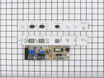

    Yes, I have had to change the main control board on some of these with this issue, yes, the adaptive defrost is built-in to the main control board.
    Here is the part# for the control board for your model:
    Part#8201659

    Thanks for the part number. I'll be keeping a close eye on the defrosting cycle and if it proves to be too infrequent I may just have to shell out for a new board.
    Too bad it's not as cheap as a new defrost timer! Having a central control board is a neat concept but makes for an expensive repair when only one function fails!

    I guess the real test is to force a defrost cycle by following the instructions:
    1. Turn off the fridge using the control panel's ON/OFF button.
    2. Press ON/OFF and the water-filter Reset button for 3 seconds.
    3. Now the fridge is in Diagnostics mode at test #1.
    4. Defrost is the sixth test, so push the Reset button five times until the water-filter display reads "6".
    Correct me if I'm wrong, but this test exercises three things:
    1. the control board's ability to activate the heater
    2. the heater's ability to warm up and defrost the evaporator
    3. the bi-metal's ability to open the circuit when the temperature gets warm enough
    So if defrost works in diagnostics mode, it means the control board is at fault during normal operation because it waits too long between defrost cycles. Yes?
    Yes, thats correct.
