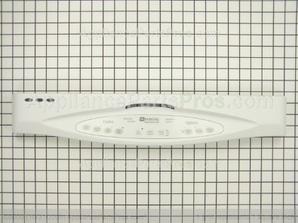

    I have a Maytag Quiet Series 300 model number MDPTT60AWW that has the same problem as many others discussed here - half of the buttons are not working now (after about 1.5 years) including Start button. Delay start is also not working. Can somebody point me to the part type/number that I have to replace? Is this something that I will be able to do without any special tools or advanced skills?
    Thank you,
    Alex
    76,096
    Hi Alex,
    Please double check your model# again, that one doesn't pull up anything.
    76,096
    I think I found your model# Alex.
    MDBTT60AWW
    Here's the control panel for your model:
    6-919846 Panel-Con - AppliancePartsPros.com
    Its fairly easy to change, just unscrew the inner door liner screws that hold the console in place, then it will come off, and disconnect the ribbon cable from the control board.

    Thanks a lot for locating this part for me (MDBTT60AWW is indeed the right model number). Before I spend $140 on this part, can you give me an idea on how often do you see this problem repeating in this type of dishwasher? Maybe it's better to take my losses and get a new model (with warranty this time.
