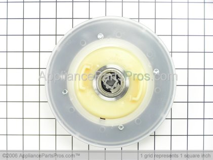

    We have a the Neptune TL Washer and it is failing halfway through the cycle. When it gets in the rinse or spin mode when washing small loads of heavy items it is struggling to balance the load. Then we get the dc or uc error code. It seems to work fine when running large loads. It also runs fine when it is completely empty. A and E sent a technician and after scratching his head awhile he ordered a Tub Sensor and a Pressure Switch. His diagnosis was when it stops running there is still water in the tub. I think it should have water in the tub when when it first starts spinning, then it pumps it out. Also I think the tub sensor is working fine because when it trys to spin and is out of balance, it stops and tries to balance the load. After about 3 tries of rebalancing the load it stops. Do any experts on here know what typically is at fault on this model when it is unable to balance small loads? It just started having this problem. It's in the 3-5 year range on the warranty and I'll find out in a week when the A and E technician comes out to install the new parts, but I didn't get a good feeling about this guys capabilities, and it seems like the parts he wants to replace are not the problem.
    The reason why the I think the parts he ordered are not the problem is when it's out of balance, it stops - that's how the tub sensor is supposed to work right? When it is in balance it pumps the water out fine - that's how the pressure switch is supposed to work right?
    Barry
    71,153
    I never worked on these before myself, but I found a similar thread about this here: Maytag FAV6800AWW won't spin
    From what gmannine says, its either the out-of-balance sensor or the clutch.
    Here is the out-of-balance sensor(Tub displacement sensor kit)
    for your model:
    12002194 Tub Displacement Sensor
    Here is the clutch:
    12002211 Pulley & Clutch Assy

    Part 1; DC or UC unbalance error codes in Spin Cycle what is causing this issue?
    FAV6800A/FAV9800A Service manual from this site.
    Assumptions; Front Struts and TDS are not malfunctioning. These can be easily checked by visual inspection and a diag routine from the Service Manual. TDS check on page 19 of the FAV6800A/FAV9800A Service Manual.
    Your FAV6800A or FAV9800A is going off balance with DC or UC unbalance error codes during spin cycle and you see/hear the wash tub banging around at the start of Spin Cycle of the wash cycle or a Spin Only cycle. If this is the condition the TDS (Tub Displacement Sensor) is working as designed and signaling the Control Board properly of an unbalance wash load condition.
    The Control Board receives a varying D.C . Voltage from the TDS sensor and if the out of range D.C. Voltage limit continues the Control Board will halt the Spin Cycle and try to redistribute the wash load. If you are interested I will show you how to monitor the TDS input to the Control Board with a DVM.
    The Control Board then starts the Spin Cycle again. If the wash tub/basket out of balance condition continues the Control Board will attempt another redistribute of the wash load. After several attempts (4 to 5 I believe) the Control Board will shut down the Spin Cycle and send a error code DC or UC to the LED display of the FAV6800A, my machine type. And I believe a text statement to the LCD screen of the FAV9800A machine i.e. something like “Unbalance Condition” I’m not sure what the text message is.
    These Maytag TL models use a Clutch Pulley that incorporates One-Way Roller Clutch bearings in the clutch pulley hub. If the first two digits of your serial number start with a 10 or 11 then you have a Series 10 or 11 machines and the Clutch Pulley will use an Upper One-Way bearing ring with this series.
    Most later series do not use the Upper Bearing ring. Maytag in their wisdom (or lack of) shifted the location of that One-Way Roller bearing ring set to be incorporated as part of the Lower Outer Tub bearing assembly. Good luck trying to find that assembly. If you ever have to change the Outer Tub bearings in a series 12 and above machine I can help you with some info. I have only changed out the Outer Tub bearings on a series 10 machine. I did work on line with a forum member that had a work around using standard off the shelf 6207-2RS bearings and some shims for a series 15 machine. That’s for another part of the FAV6800A sticky.
    The root cause of the DC or UC unbalance error code is caused by the Clutch Pulley One-Way Needle Roller clutch bearings not locking up in the CCW direction (the Spin direction) as the Washer enters into a spin cycle.
    Here is the wash cycle process with more detail;
    The Control Board runs thru wash cycle selected signaling the Motor Controller to power the Washer Motor to spin the Clutch Pulley with Clock Wise rotation. The Clutch Pulley rotates CW driving the Agitator shaft to drive the transmission rotating the tumblers. The Clutch Pulley One-Way Needle Roller clutch bearings rotate freely in the CW direction the wash/agitate direction of Clutch Pulley Rotation.
    As you reach the Spin Cycle of the selected wash cycle the Control Board signals the Motor Controller (PWM digital signal) to drive/power the washer motor in the CCW direction.
    The One-Way Roller Clutch bearings should lock up solid with CCW Clutch Pulley rotation. Once the large wrap spring comes under tension in the Clutch Pulley hub the wash basket will begin to rotate CCW the Spin direction.
    When the Clutch Pulley One-Bearings become dry they fail to lock up solid in the CCW direction and they slip. This will cause slight agitator rotation causing tumbler movement with CCW rotation (Spin Direction) of the Clutch Pulley. Excessive tumbler movement in Spin Cycle will drag the wash load off balance causing the wash tub to swing off balance. Some folks have gotten thru this issue with extra load in the wash basket to help stall/add resistance to tumbler movement during the start of spin cycle.
    With no wash load in the wash basket you complete the spin cycle regardless of tumbler movement….. there is no wash load to drag off balance and the Spin Cycle completes.
    That’s my overview as an owner of the machine. I have helped many owners thru this issue that wanted to DIY the fix and extend the machines service life. Mine failed at the 3.5 yr mark with DC/UC unbalance error codes.

    1. Lean the washer back and blocked up in that position against a wall for a better reach angle or on the floor as described above. Loosen the 3/8” clutch Pulley bolt. The 3/8" bolt is standard thread not reverse. I find it easier to lay the machine down on the back panel blocked up tp clear the drain line exit. Then hold the Clutch Pulley with one hand and loosen the 3/8" bolt with a socket wrench.
    2. Follow SM page 46 & 47 to remove clutch pulley.
    3. Remove 4 screws holding plastic cover on clutch assembly see Pic 1. Inspect clutch spring to make sure it is not broken. If either clutch spring retaining end is broken off then the clutch must be replaced. Inspect Roller Clutch bearings and clean up with WD-40 and re-lube with Slick 50 One Lube. Some machine series use an Upper Roller Clutch bearing and always a lower clutch pulley Roller Clutch bearing. My series 16 machine doesn’t use the Upper Roller Clutch one way bearing. These bearings are one way rotation bearings in the Clockwise direction. Make sure the Spinner Shaft Coupler will rotate freely in the CW direction in both Roller Clutch bearings. If the Roller Clutch bearings or Spinner Shaft Coupler will not clean up with WD-40 I recommend a clutch replacement.
    4. Replace white bearing plate into clutch pulley hub, insure key slot slips into clutch Spring pin in the clutch hub.
    5. Replace Clutch plastic cover with 4 screws.
    6. Reinstalling the Clutch Pulley assembly is the most difficult part of the process. With a tight work area try a test fitment of seating (if used) the Upper Roller Clutch bearing with the notches into the bottom of the wash tub. Then insert the Spinner Shaft Coupler into that bearing rotating CW to reseat the coupler notches to the spinner shaft. Then the clutch pulley to the squared end agitator shaft. Rock back and forth the clutch pulley assembly with upward lifting pressure to reseat the clutch assembly. When the clutch assembly is properly seated you will feel a 1/16-1/8" gap between the Pulley face and shaft end as mentioned and shown on page 47 of the SM. On reinstallation, tighten Clutch Pulley bolt to 96” pounds 8’ foot pounds (Snug no torque wrench required). The Clutch Pulley 3/8 bolt is standard thread not reverse.
    7. Do a quick wash and make sure clutch runs true with no wobble or clicking sound. If the clutch has not been seated properly it will spin off. If this happens go to page 16 of the SM Board Output Test and turn on Drain Pump in Service Mode to pump out excess water.
    8. Repeat steps 6&7 if the clutch has excessive noise or spins off.
    Before you clean up the Clutch Pulley One-Way Roller Needle bearing try this little test to better understand what the issue is;
    See Pic 1, 3 and 4;
    Holding what I call the Spinner Shaft coupler first picture. Insert that coupler into the Clutch One-Way Roller bearing plate. Now while holding the Spinner Shaft Coupler with one hand as I show in the 4th pic with your other hand rotate the white bearing plate in the CW direction around the Spinner Shaft Coupler.
    The One-Way Roller Clutch bearing plate should rotate freely in the CW direction this is the wash/agitate direction. Now rotate the One-Way Roller Clutch bearing plate in the CCW direction it should lock up solid.
    Most times the One-Way Roller clutches will slip did it slip for you? This will cause the agitator shaft to move slightly causing slight tumbler rotation while the wash basket begins to spin up unbalancing the wash load causing big time wash tub swings and those pesky unbalance error codes.
    I hope you have success post back with any questions.....Dick
