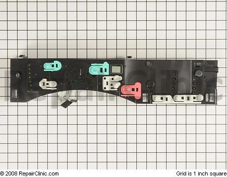

    I have a Whirlpool Duet dryer GEW9200LW1, and the main indicator settings light jumps from setting to setting as I turn the primary settings knob. For example, if I try to select Normal cycle, I turn the knob but the indicator light jumps from Delicate to Heavy duty. Rarely is it actually pointing to the setting that is illuminated. I cannot actually select the Normal cycle. The dryer seems to be working fine other than this annoying issue. What can be wrong and what do I do to fix it?

    The problem is your user interface control board.
    Here's the user interface control board for your model you can order here:
    Manufacturer part number 8530589 is RepairClinic item number 922858
