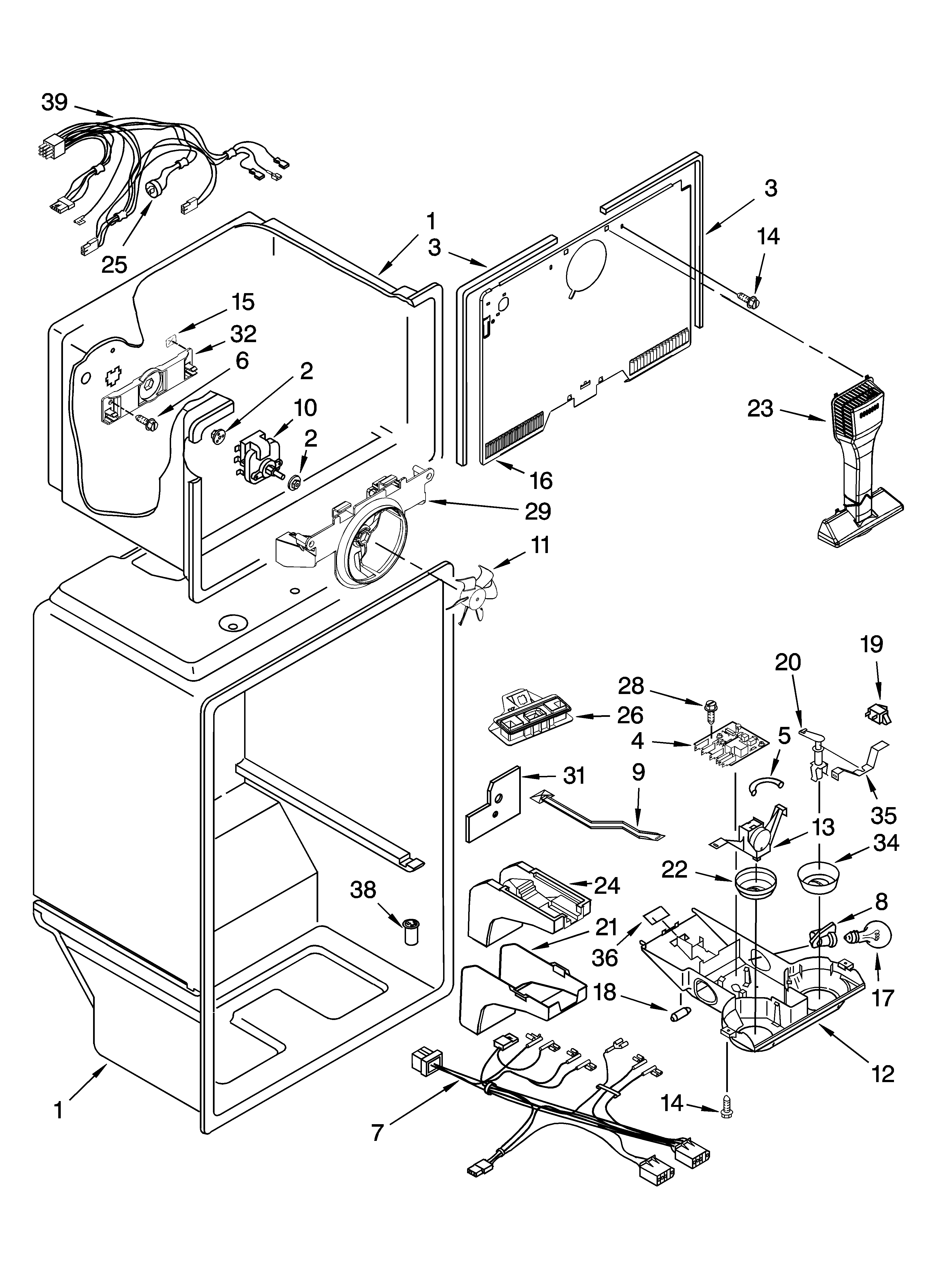

The problem with that my refrigerator ET1CHEXSQ01 is making to much ice in the freezer and it is warm in the refrigerator.
Call a tech and said that is the evaporation motor and want to charge me 350 dollars for changing it.
The point is that when I saw what it was I check for the part and is on average 40$. Nevertheless, when I went to order the part the vendor told me to clean the part and oil with sv40 and that is it.....it was working for a month now the problem is back....any clue?
should I by a new fan?
Thanks for your help,
Jorge Mario

Yes, your evaporator fan motor went bad, I've replaced lots of those on this model before.
Here's the one for your model:
Manufacturer's Number: 2315539

Do I need especial tools to unsemble the fan and reinstall it?
Thanks a lot for all,
Jorge
Old October 15th, 2009, 07:20 PM
Posts: 30,223
No, the fan blade just pulls off, then should be 2 screws that hold the motor in place.
Unplug your refrigerator first.
You have to first remove #29 here first:
http://c.searspartsdirect.com/lis_pn...2027-00003.png
that may have 4 screws that hold it in place.
