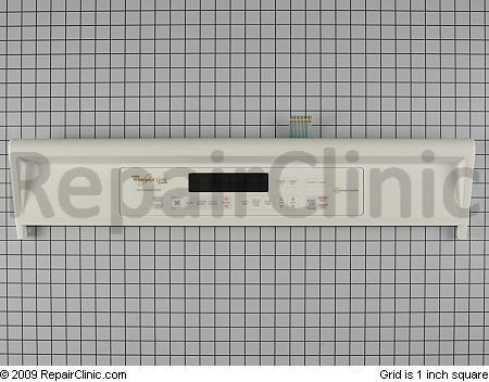

Default Whirlpool GBD307PDQ09 has error code PF E06
Error code is PF E06 what exactly does this mean? I haven't found this code in the code list. The display is blank in the control panel so what part is needed? The light still comes on inside the oven and the buttons will beep but nothing else happens.

1. Check keypad connector for firm connection.
2. Press CANCEL. If error code returns after 60 sec., replace keypad.
3. Replace control.
Here's the control panel keypad assembly for your model:
Manufacturer part number 8300441 is RepairClinic item number 904499
8300441
Your control board is this part:
Manufacturer's Number: 8302319
