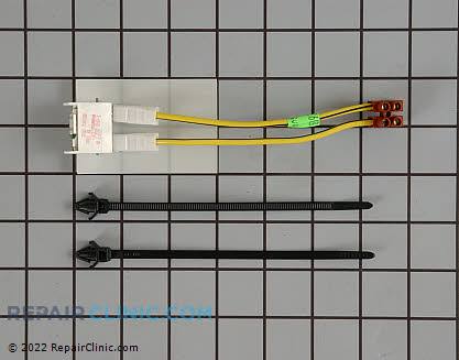

    Check for an open ( no continuity ) thermal fuse...it is in the consol...
    Fuse kit with wire harness and instructions

    So I pulled out the control board and I ohm out the thermostat and I get an open.
    I've ordered the part, but I have a question.
    What causes this component to fail/open?

    Most commonly has been a loose connection in the fuse itself....that why it is important to use ALL of the kit....sometimes a bad heating element, thermostat...

    I got the new TCO.
    What's with the screw-on connector?
    Can't I just disconnect the spade adapters from the old one and plug them on the new won?
    Also, you mention that the heating element might be what caused the TCO to blow, is there a way to test the heating element so I don't hook up the new TCO and blow it right away?

    No Brian, YOU MUST use the new wires that come with it.
    I took the easy way one time and had to go back because it blew out again, then I changed the wires that came with the kit, never went back again.
    63,679
    From my experience, its the faulty original wires that make that fuse blow.

    Is it the spare connectors themselves that have a problem? As that is the only part that is replaced as far as the wiring goes?
    I did just put the fuse in, and it did blow again.
    I guess I'll order another and do the wiring thing and see how that goes.
    Is there something else I should be checking?
