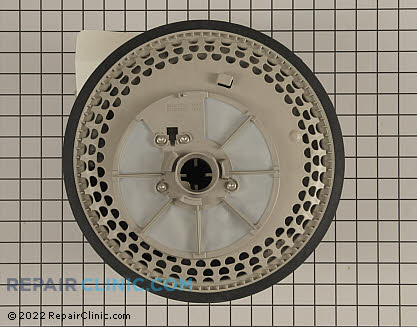

    Jake, since last post, I've had to replace the drain pump as the impeller continued to come off. Now the Main circulation pump is sounding bad when it's running. Sounds very loud, like a dry bearing. I pulled the main pump off and the impeller assembly is pretty hard to turn by hand, so I'm fairly confident it needs to be replaced. Dishes haven't been getting very clean as of late, I'm guessing this failing pump could be contributing. Do I understand your return policy correctly, that if I order your pump and find my dishes still aren't getting clean, I can return the part for a full refund?
    I'm at a point now where I don't know if it would be better to just buy a new machine and ditch the whirlpool. I'm willing to to replace the pump with a money back guarantee, but by golly, I think this will be the last part I replace on this machine...
    whadya think? Should I give this whirlpool one more chance? think the pump will bring it back to life? Any advantage to replacing the entire sump assy over just the motor?
    Yes Mark, Thats exactly correct.
    Yes, since its not that old, I'd fix it, not replace it. Yes it will be like new again.
    Yes, getting the complete assembly is much better than just the motor alone.
    Here's the sump/motor assembly for your model you can order here:
    Manufacturer part number W10237169 is RepairClinic item number 1548391
    Here's the video to change the sump/motor assembly:
    Keep us posted.

    Thanks, Jake. Just so I know what I'll be getting in the mail... does the sump assy contain a new check valve and chopper assy along with the circ pump? just wondering if I should replace those while I'm at it. They both look to be in good shape but if they come preinstalled on a new sump assy all the better.
    Thanks for your advice on this machine. I will say this about the Whirlpool, it's a pretty easy machine to work on, once you know what's what and where everything is located. Your website makes identifying and troubleshooting a snap!
    I just wish it would stop breaking...
    Mark
    55,588
    59
    Thanked 3,151 Times in 3,129 Posts
    Yes Mark, It comes with new check valve, new chopper assembly, new circ pump motor, all come pre-installed.
