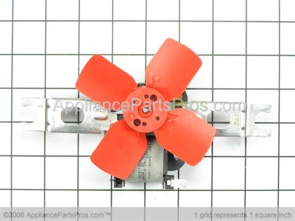

Sears Kenmore top mount(freezer on top) refrigerator(model#1068668883): Not cooling properly, I found the evaporator(freezer) fan motor not turning, the bearing had gone out in it. Installed new one, worked great!
Here’s the evaporator fan motor for this model(Comes with installation instructions):
Manufacturer’s Number: 482731
