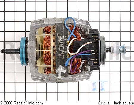

Sears Kenmore/Whirlpool Dryer Motor
We seem to be having lots of members coming to our dryer forum and are having their dryer motor starting to fail, after about 8 years dryer motors can simply just wear out under normal use. The sign of a dryer motor going out is when you start the dryer it makes a grinding sound and runs a little while then just stops completely.
Here’s the most common dryer motor for the Sears Kenmore/Whirlpool models with the lint filter on top of the dryer:
Manufacturer part number 279827

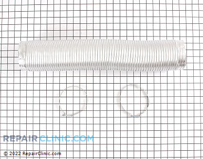

Flexible Dryer Venting Kit
Dryer venting restrictions and clogs are very problematic for proper dryer performance. If you notice your dryer taking longer than normal or if you have to run two or more drying cycles just to get your clothes dry, I advice people to check their dryer vents first before anything else.
If you find your dryer exhaust flexible hose/ducting is torn or kinked, its best to replace it.
8 Foot Flexible Dryer Venting Kit
