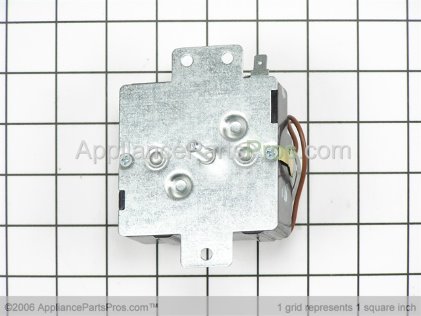

Whirlpool Dryer Heating in Cool Down and Air Fluff
Whirlpool Dryer model number LER6620PQ0
Unplugged dryer, ohm tested heating element to heater housing to check for grounded element, heating element ohm tested good, and not to the heater housing ground either.
Found stuck contact in timer causing this problem, Installed new timer, worked great!
Here’s the OEM timer I replaced for this model:
WP8299778 Timer
