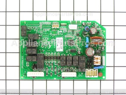

Thanks Jake. I saved the original bi-metal. Put it in my other refrigerator's freezer compartment an hour or so and it is now showing continuity. (Recall that during original troubleshooting I just cooled it in place with the coil for a few seconds). So I am thinking maybe it was not the bad actor in the first place. Does this mean the control board may be bad? Any way to confirm this before ordering a new one?
Yes, If your defrost heater and defrost thermostat ohm test good, then the only other part that would cause this problem is the control board.
Here's the control board for your model you can order:
WPW10516800 Cntl-Elec
