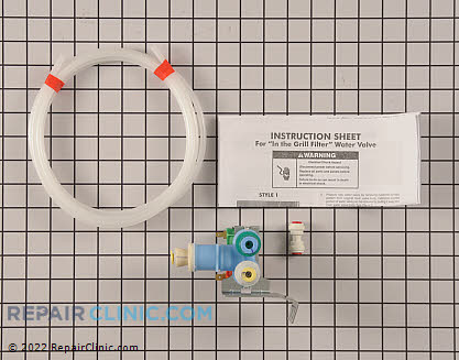

I always check customers water pressure before I do anything.
Pull your refrigerator out away from the wall, turn off your water supply line that goes to it, then take off your water supply line from the water inlet valve, then get a bucket, cup, bowl, etc to catch the water, then put your water supply line in the bucket and turn it on, your water stream should be really good with good water pressure, if not then the problem is in your plumbing water supply line, either a bad or clogged shut off valve.
If your water pressure checks good then your water inlet valve in the back of your refrigerator is likely bad OR the plastic water line tubing broke.
Water Inlet Valve W10408179

Btw, I didn't need an entirely new inlet hose. The part missing from the main water valve PCV line to the water line that runs to the refrigerator was a compression sleeve and brass insert. $1.44 part. everything works great, now. :)

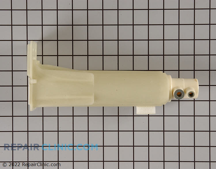

And, 4 years later, the water line spontaneously split, spraying water everywhere and flooding my kitchen. I found this old post and your link to the water line that is exactly the one that I need. I ordered the part, however, I have one concern. The inlet goes from the valve to the water filter housing. To detach the old hose, I had to pop out this gray plastic piece that may or may not have assisted the line with staying inserted. Where can I find that grey insert? I'm not sure if this hose line will simply stay inserted without it. This is the 2nd inside hose line insertion point in this part:
Water Filter Housing WP2186443
Do I really have to buy a whole new housing unit or was the grey part a little cosmetic? The part is not broken, well, one tab broke when I was taking the tube out, and it could still be reusable. Thoughts?
You are referring to this gray ring below where the tubing line goes into it? If so yes, that is the compression ring that keeps that water tubing line in place.
