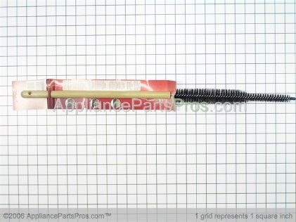

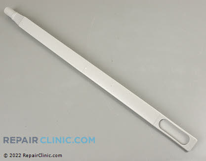

Are your condenser coils underneath the refrigerator clean? Just open the both doors, then pull that kickplate grill off, PULL HARD it just unsnaps.
You can use a vacuum cleaner attachment or condenser brush to clean your condenser. Even better would be if you have an air compressor or shop vac to blow the condenser coils out, yes its a bit more messy on your kitchen floor, but it cleans it thoroughly.:)
Refrigerator Condenser Cleaning Brush
Vacuum Hose Attachment 8171579A
