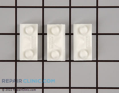

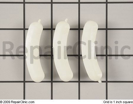

Hi, In your video it looks like its spinning properly with no clothes in it.
But with a smaller load if the machine walks, then that seems like your suspension pads AND tub wear pads are worn out, that will cause this issue.
Here's the suspension pads for your model you can order here:
Manufacturer part number 285744
Video Included in part link.
Here's the tub wear pads for your model you can order here:
Manufacturer part number 285219
Glad to help, let us know how it goes.

The old suspension pads were a little flat on the tops (photo), but the wear pads looked almost new. But since I had everything apart, and had the parts, I went ahead and changed them too.
