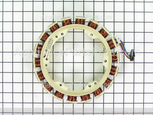

I am wondering if anyone can help. My Kenmore 700 Series Model 110.28132410 smells like something is burning. Hear sparking noises and it will not run any cycle.
It just started today. I took a pic of the bottom. Not sure if its the motor and its burned or if that is dirt from the bottom.
Looks like your rotor bolt is missing or sheared off the bottom of the rotor.
Here's your rotor bolt: W10752189
This video shows you how to access it:
Also, check to make sure the rotor is not cracked.
Here's the rotor for your model:
Rotor W10754161
It also looks like possibly the motor stator burned up too.
Here's the motor stator for your model:
Stator W10754158
