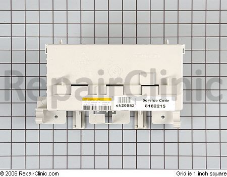

Check your door when it closes, it should hit a push-in button above that door latch, at times I have seen the door hinge bent down just some, causing the door not to strike that button dead on.
If thats fine, then its likely the CCU board bad.
Your service guide is located inside the bottom of your washer, you have to open that lower access panel off, it has 3 torx screws at the very bottom of your machine. That panel pulls forward and down, then you will see it mounted on the right side taped to that inner panel. You can put it in a diagnostics mode.
Here's the CCU(microcomputer) for your model, in case you need to order it:
Main Control Board WP8182215

Thanks for the help Jake. Do you think it's possible to complete the circuit on the latch so the CCU thinks the door is locked? The switch does lineup I just feel that not enough voltage is being sent to fully trip the Latch. I'm confident the soft lock would hold the door in place during a washing load. And just wondering if I can bypass the latch and connect the two wires of the latch switch so the CCU thinks the door is latched so it can continue the cycle. What are your thoughts?
106,237
I've never bypassed the door latch, I don't know of a way to do it.
You really need to run the diagnostic mode to see what error code you may be getting.

Hey jake the diagnostic mode just came up with the same code F/dl ... again i have replaced the door latch, cleaned the connections. Every time it tries to latch the door it's a soft click noise vs. the louder click it makes when the door latch actually engages. If i leave it unplugged for a while it'll work 1 out of every 20 attempts... do you really think it could be the CCU?
