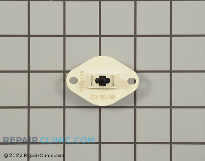

You would need to take off the lower front access panel under your door, then take off the duct assembly#45, by removing the two #32 screws, Unplug or turn the breaker off to your dryer first before opening it up and ohm testing.
Then you will need a ohm meter to ohm your thermal fuse and thermistor. They sit next to each other on the top of your blower wheel housing.

If your thermal fuse checks good, then ohm your thermistor, that should read about 10,000(10k) ohms at room temperature.
Here's the thermistor for your model you can order here if needed:
Thermistor 8577274 Order now for same day shipping. 365 day return policy. RepairClinic.com

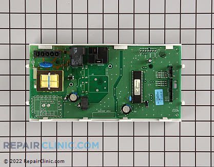

according to the papers on the dryer (we finally found inside the panel), hubby checked all the codes, everthing it said to test. It does show up a code not listed in the book (E4), anyway, it finally boils down to either the door switch or the main thing (computer?). I guess we have to order both to see which it is. If it is the door switch, will the light still come on? Our light still comes on when the door is open! So now I have to find out how much parts are.... part numbers: 8519323 -- door switch, and 8546219 -- machine control electronics. Thanks again....
Yes, the light switch should be fine if the light comes on in the drum with the door open, but push the door light switch in and see if the light goes off as well.
So its likely the machine board thats bad.
Here's the machine electronic control board for your model you can order:
Main Control Board WP8546219 Order now for same day shipping. 365 day return policy. RepairClinic.com
You can return it if you install it and it didn't fix it for a full refund within 365 days.

You will want to look at your control board closely, for any burnt spots on it. That's common when the dryer won't start is to see burnt spots on it. If you do find any burnt spots on it, then you'll need to replace that board and you'll be back in business.
When you click the link to the control board below, there is a video that shows you how to access it.:)
Here's the control board for your model you can order here:
Whirlpool WP8546219 Control Board
Ok, so this looks like the board that is on top of the dryer not the part that has all the buttons on it to change cycles etc?
I looked at the board and it looks good. There is one small spot that is a little dark under one of the relay's but not too bad. That is the only spot where I can see anything, but it doesn't look that bad to me. Do you know do those relays fail very often? there are two of them right next to each other?
Yes, that could be the problem, they can fail after years of use.
If your thermal fuse and door switch ohm test good, then that's the only part it can be is the control board.
flyboy my story is the same as yours. It was very hot then a no go. heating circuit is fine, door switch good. I have read teh same thing can happen if the belt tension switch fails, the switch it tough to get to. I also have a dark spot on the back of the board, it is directly under where one of the legs of the 140 volt circuits land on the board but i have continuity right through there.
I am hesitating to buy the board because i have read it does not fail very often.
Please let me know your results.
Then you will need to order a new control board and that will fix it. What is your model number?
