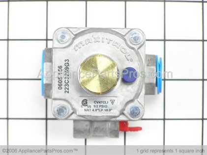

    When you first turn your oven on, how long does it take for the gas to ignite from the glow bar? If it takes longer the 45-60 seconds, then its your oven glow bar igniter:
    GE WB2X9154 Round Style Oven or Broiler Igniter - AppliancePartsPros.com
    If it ignites with 90-120 seconds then it sounds like your main gas regulator is possibly the problem.
    Here's the one for your model:
    GE WB19K1 Reg Pressure - AppliancePartsPros.com

    The oven burner consistently ignites in 45 seconds then the flame size reduces 15 seconds later. I will look into purchasing a new regulator, unless you think there could be other possibilities. Thanks for your help!
    82,071
    Ok, it sounds like a regulator issue.

    I ordered and replaced the gas regulator for my Kenmore gas range/oven (model # 362.7351892) in hopes of resolving my slow warm-up oven issue. Unfortunately I still have the same problem.
    The oven burner ignites in about 45 seconds then the inner cone flame size reduces to < inch about 15 seconds later. The oven takes 45 minutes or more to heat to 350 degrees F.
    I have made sure that the shut off valves on the regulator, and the main valve to the range, are completely open. Adjustments to the orifice hood and air shutter valve do nothing resolve the issue.
    It seems to be a gas flow issue somewhere, and the only thing I see left is the gas valve for the oven & broiler. Is it possible for the gas valve to go bad by opening only partially? Or maybe the igniter resistance is too high and not letting the gas valve open completely? How much current should be flowing through the igniter and valve?
    Any thoughts?
    82,071
    Yes, its very rare I see the oven gas valve fail, Its more likely the oven igniter resistance not opening the oven gas valve fully.
    You can return that gas regulator for a full refund, then order the oven igniter.
