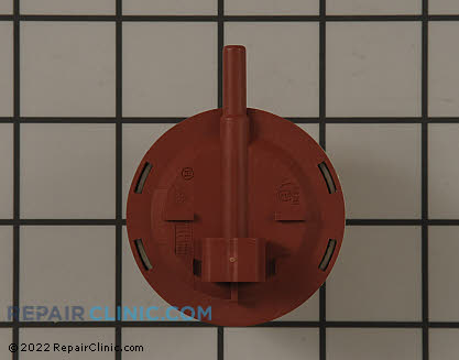

    Sounds like the pressure switch is causing this issue, bypass the pressure switch underneath the dishwasher, if it starts running after it fills and not draining, then you will need a new pressure switch, the pressure switch is the part where that rubber tube go to from the pump.
    Pressure Switch 3380871 Order now for same day shipping. 365 day return policy. RepairClinic.com

    The new pressure switch arrived in the mail yesterday and I swapped it out. It did not change anything . I tried blowing on the inlet of both pressure switches, and they both sound like the switch activates with about the same pressure.
    Do you have another suggestion? I am guessing that since the pressure switch being activated early seems to be causing the problem (since disconnecting it allows the cycle to complete) and the switch is good, that the problem must be that the hose feeding the switch is sending it high pressure as soon as the pump starts. What might cause that?
    82,255
    Thats very odd , because you said you had by-passed the pressure switch and it worked great, that new pressure switch should have fixed it up.
    The only other part would be the sensor itself thats intermittently acting up.
