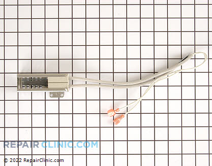

    i have the same katy. i had a problem with the f1 e3 and fixed it with the code sequence above but now the oven doesnt work. i press broil and it seems like its working but bake doesnt work. it makes a sound when i press bake and start but it doesnt heat up. if anyone can help me that would be great.
    thanks,
    kelly
    83,394
    Ok Kelly,
    Open the oven door and start a bake cycle and look at the bottom of your oven, do you see an orange glow? If so, the gas should ignite within 45-60 seconds, if not, you have a bad bake igniter.
    If you see no orange glow, then it still can be the bake igniter, in that case you would need a volt meter to check for 120 volts with a volt meter at your oven bake igniter while the oven is ON. If you have 120 volts at the oven bake igniter and the oven bake igniter doesn't glow orange, then the oven bake igniter is bad.
    Here's the oven bake igniter glow bar for your model, in case you need to order it:
    Igniter 9782065 Order now for same day shipping. 365 day return policy. RepairClinic.com
    The oven igniter terminals are under the oven in the very back, so you'll need to remove your storage drawer and get a flashlight and put your meter leads on the terminal ends of your oven igniter.
